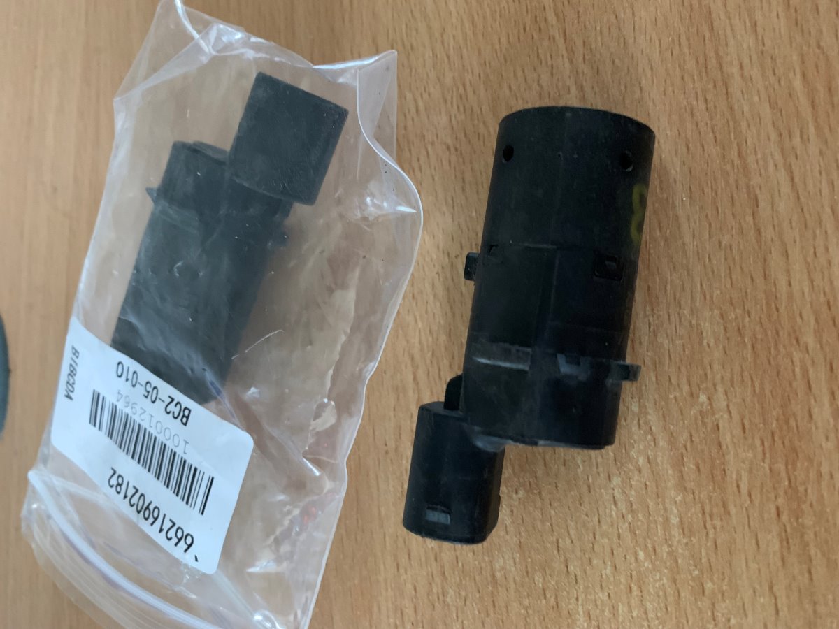

This weeks conundrum is the PDC failure on my E53. The symptoms are that when the PDC is switched on either by selecting reverse gear or pressing the PDC button, I get a constant tone for a second or two then a flashing PDC button and nothing else (I bought it knowing this). I have listened really carefully to all 8 sensors and found the I had 2 silent ones (1 front and 1 rear). Great, I'll order 2 replacements. I've gone for non genuine eBay ones in this case.
BMW part number: 66216902182
eBay item number: 323217587618
I did pull the sensors out at this stage to get a look at them so I could compare them to the eBay ones and decided to swap ones from another position to check the wiring was good. And it was.
So the replacements turned up, I fitted them, and now all 8 are ticking. I've come to try them out and sure enough I've got the same fault as before. Can anyone help me from this point please?

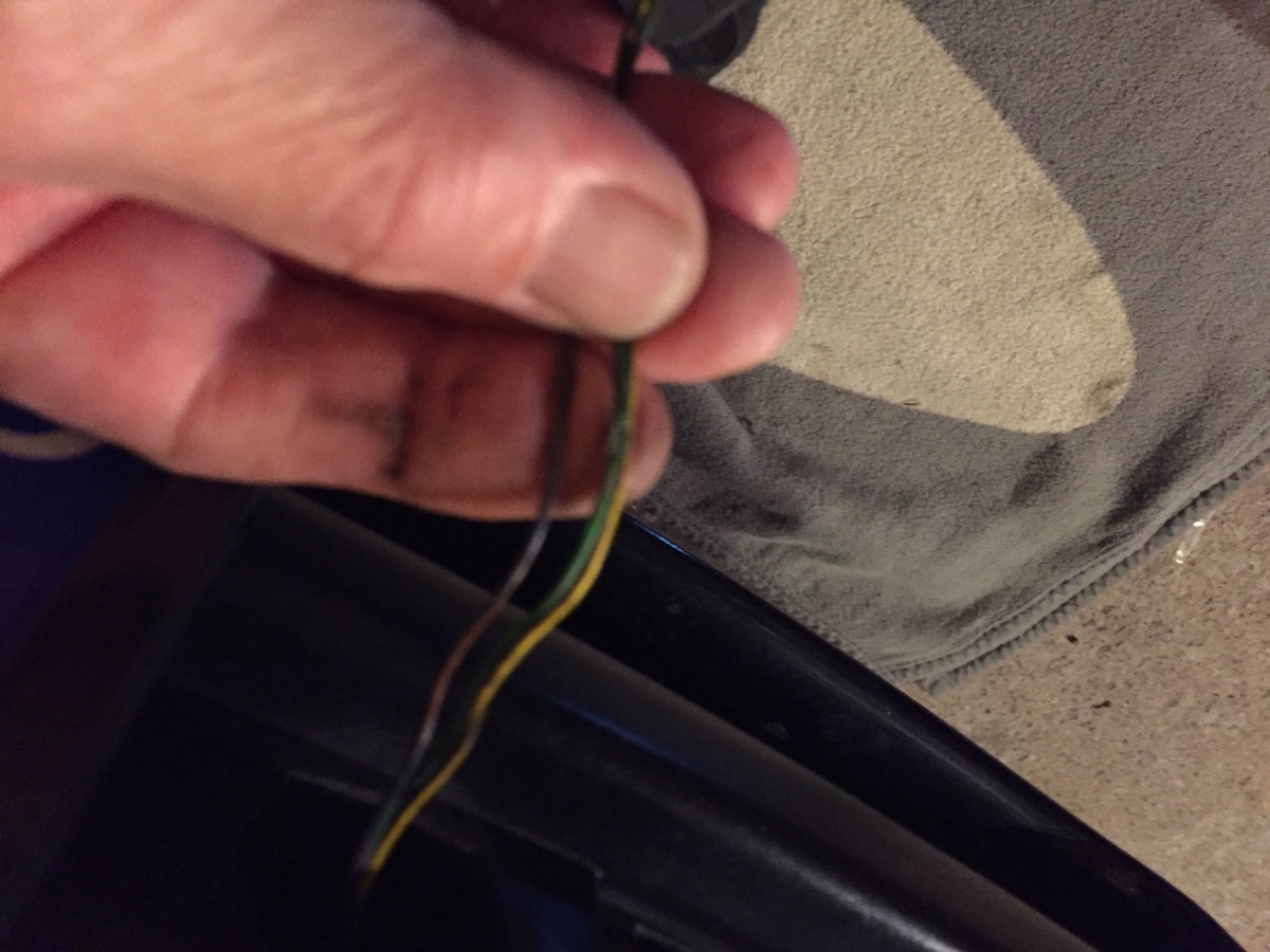

After some more fiddling with INPA ( only just got it ) it tells me that there is an earth fault. Having recently (two weeks ago ) had the front bumper off I thought that might have something to do with it. Undone all the bolts and screws and the system starts to work again? Some more work and find I had trapped a wire on refitting the bumper and the minuscule vibrations had taken 2 weeks to wear through the coating and cause the earth problem.

Really poor pic but you can see the minute bit of damage
