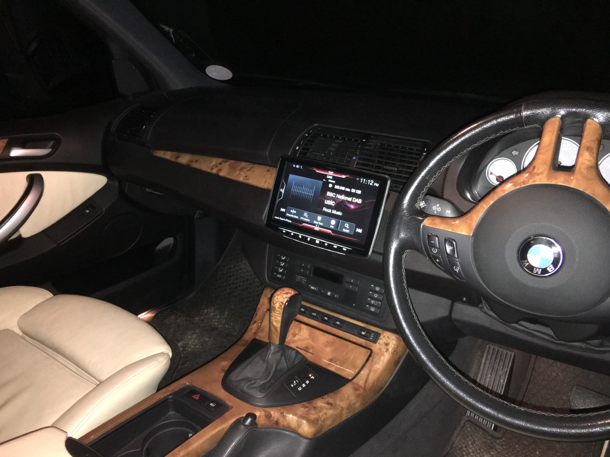

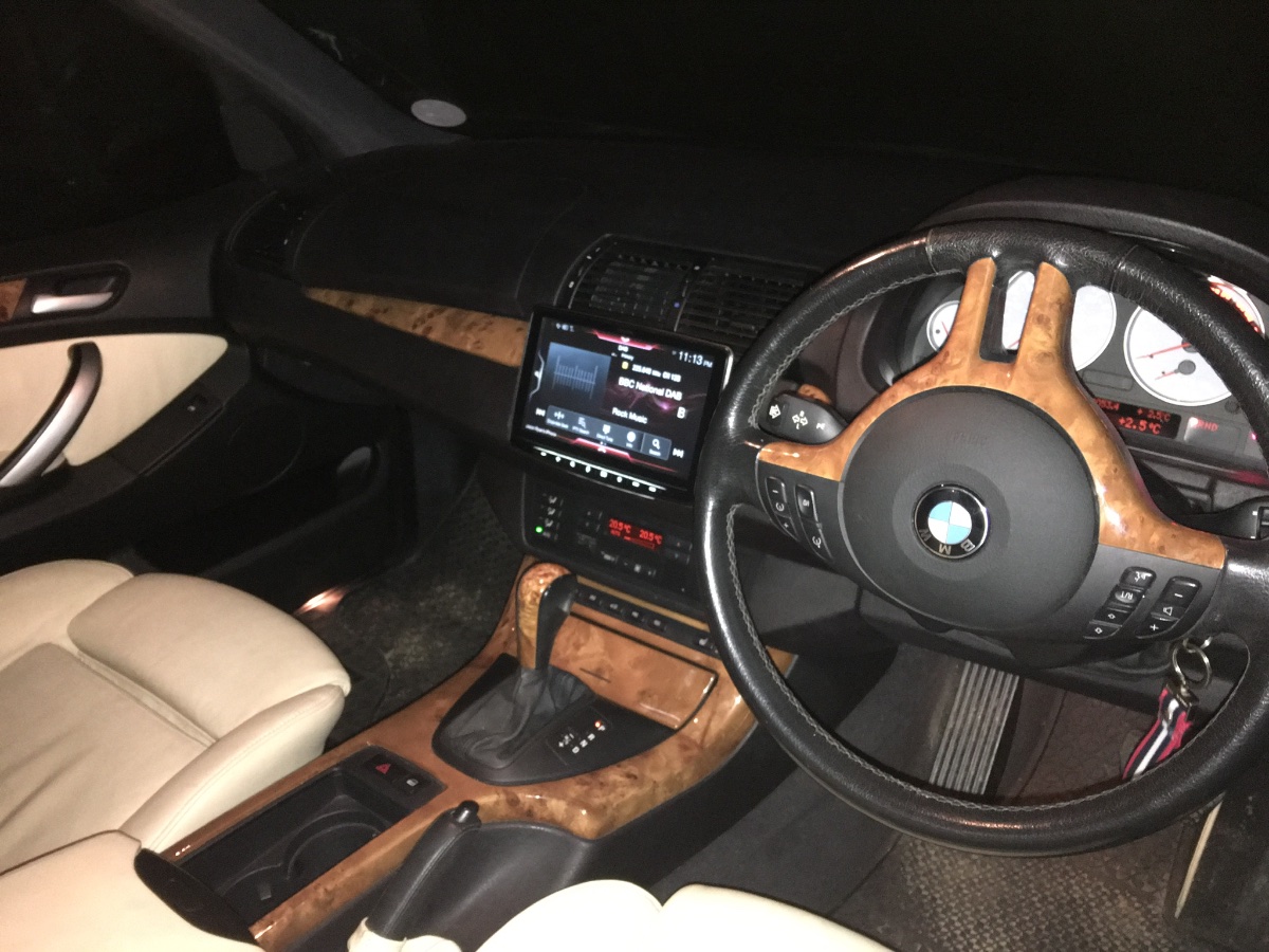

I had a Dynavin N7 - nightmare and never worked properly, then had an Alpine unit fitted - bit Marmite but I like it :lol:
https://www.alpine.co.uk/p/Products/Sin ... /iLX-F903D
Steering wheel controls retained as well. It’s all a bit more involved if you’ve got the DSP amp, if you haven’t - happy days
