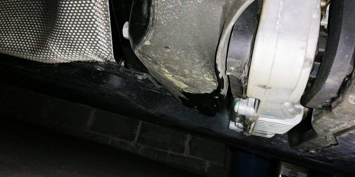

Hi All
I have a 2012 BMW X6 M50D with 50000km on it. Recently noticed some oily residue on the cross member holding up the transfer case. The residue did not have any smell to it. Upon closer inspection the transfer case was bone dry (I especially checked around the shaft seals, actuator motor and fill plug). I wiped the the cross member with brake clean. A week later the residue came back and I checked the transfer case again which was bone dry. Picture attached. Anyone can explain where this residue is coming from or what it is?
Thanks,
Sam
Thanks,
Sam

Re: Transfer case leak?
You say you checked the fill plug but did you also check the drain plug?
There's no drain plug on this transfer case
This data from the BMW Tech Instr may help? Newtis is a copy of the official BMW Dealer used maintenance & repair guide.
Yep already went through the newtis / realoem sites to see if there was anything obvious. My transfer case is the ATC45L which only has a fill plug.
Found this ‘exploded’ drawing which might offer a clue?
http://jpat.co.uk/uploads/1/0/3/5/10354 ... atc45l.pdf
It not having any smell is a puzzle as that often means water. Odd place for it and an odd colour/consistency (which is very oil like) unless there is a drain for something nearby? Body wax that’s got hot maybe?
Looks from the pic to be oil rather than fluid?
I have a picture of the underside of the X6 and that looks to be close to the gearbox/transfer box join (assuming front is to the left?). Hard to tell because of all the covers etc BMW have installed under the X6 models.
Have you had the car in the air and the underbody shielding off?
There are also two vent pipes that come off the top of the ATC45L and seem to sit just above that area. Could it be from there?
Thanks for the response. In my picture the left of the pic is the rear. I've had the shield rear of the TC removed and could not see anything.X5Sport wrote: Sat Aug 31, 2019 4:48 pm I have a picture of the underside of the X6 and that looks to be close to the gearbox/transfer box join (assuming front is to the left?). Hard to tell because of all the covers etc BMW have installed under the X6 models.
However the the vent pipes sound logical as they sit just above that position. Will check again. Is it normal to have some residue coming out from vent pipes?
Rechecked everything. Cross member still has the residue. Everywhere on TC is dry. checked vent hose also dry. Very baffling. Does anyone know where the AC evaporator hose thing is?
For piece of mind I would get the levels checked on all my fluid levels.
It could also be the gearbox vent tube which is in that area.
Have a look at newtis.info (BMW Service Manual copy) on line. Realoem may help identify the parts too.
You just need the last 7 of your VIN to pull up the right model.
The a/c drain falls into the front prop-shaft rear UJ - hence BMW having to replace prop-shaft under a recall. Make sure all yours have been done! A main dealer will tell you if any are outstanding on your car.
