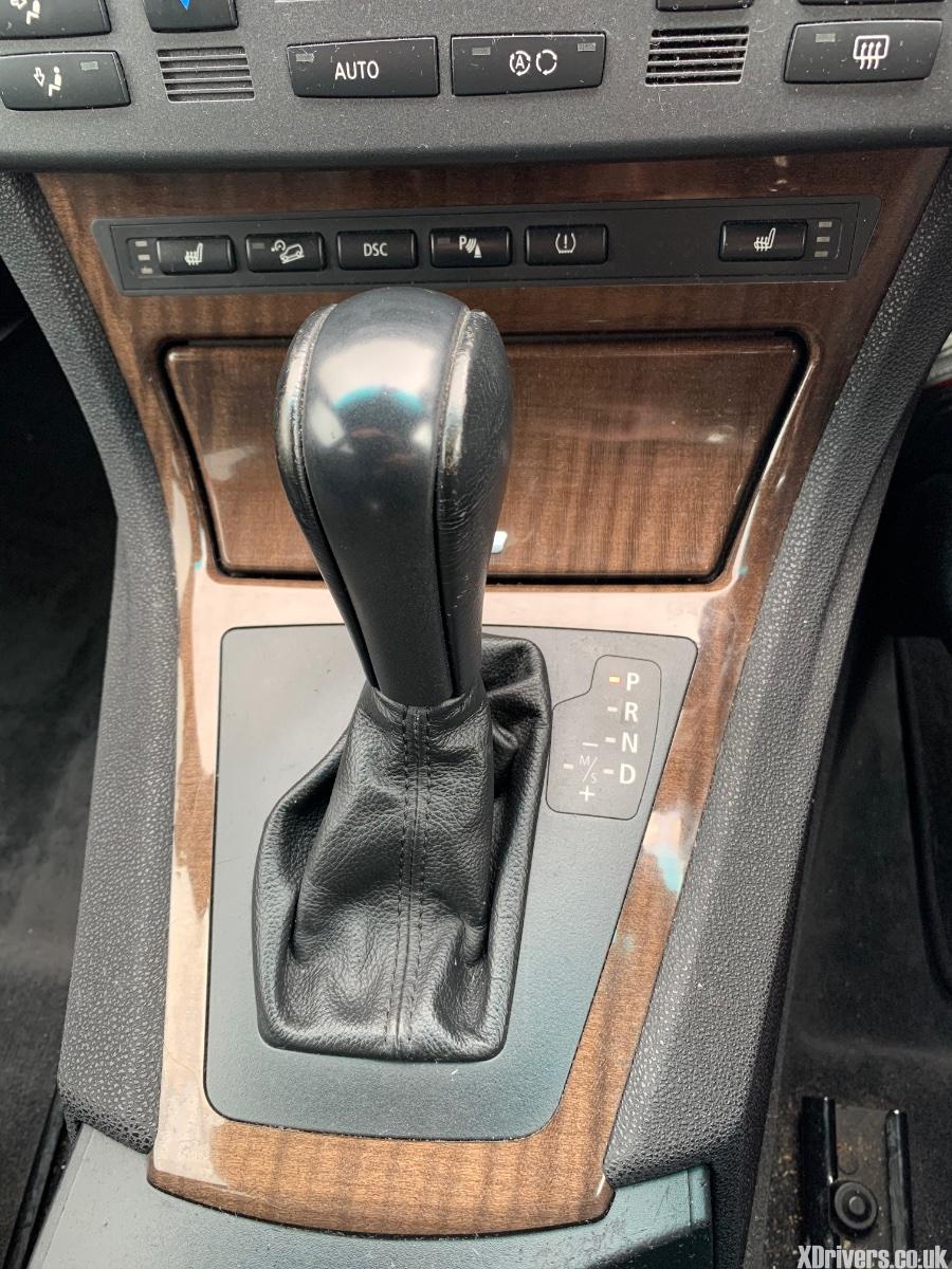

As it looks like there’s no Haynes manual for the X3 I’m hoping someone could tell me how I remove this? The *** lighter doesn’t work so I’m thinking of fitting a USB socket in place of it,can’t see any visible fasteners so does it clip out?

The gear shifter and leather gator can be unclipped/pulled up to remove them. The black plastic surround needs to also be unclipped from the wooden surround. Once there you will see a screw and clip to help hold it in place.
You also need to pull away the climate control panel to be able to undo the 2 screws at the top of the wooden surround.
Should then come out.

Thanks Raj just the info I need
