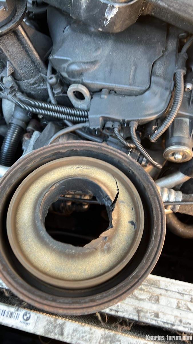

Just had a look and lower crank pulley has failed. Looking at eurocarparts they want £499…wtf

aux belt failure x5 40d
I confess I'm not sure exactly what those images depict but it sure looks broken

Its basically the crankshaft pulley which has split into two parts where the rubber joining them has deteriorated, split then separated.

And that item is basically £500 ? Life is increasingly a pi$$ take in so many ways, with so many ways to be ripped off.

I managed to find one on ebay for £200 but the seller uses royal mail who are striking. Guess the car will be off the road til next year
Saving £300 is probably worth a bit of inconvenience
