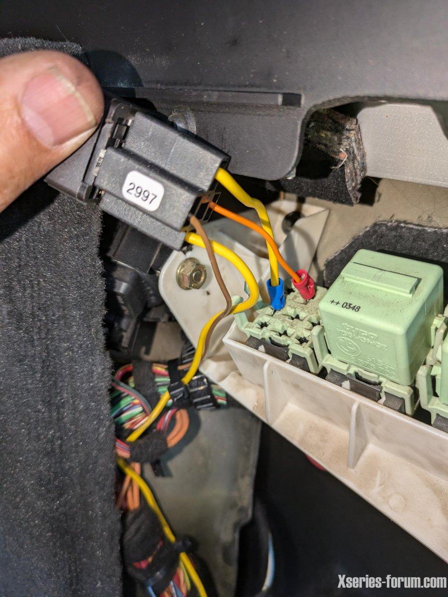

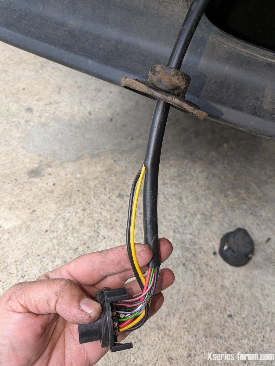

Just to close this thread, here's what I did.
Run 2 x 2.5 mm sq cables down to the socket. Yellow and black in the photo. I slit the sleeve to create entry and exit points.
In the spare wheel well lead the earth to the left and connect to the earth point. Lead the supply cable to the right and up into the fuse box cubby.
Up in the fuse box use the vacant left hand relay slot to access both the permanent live and switched live terminals to energise the fridge relay. The orange goes to switched live and yellow to permanent live. The brown wire is the relay coil earth which is connected to an earth point just behind the relay that you can't see.

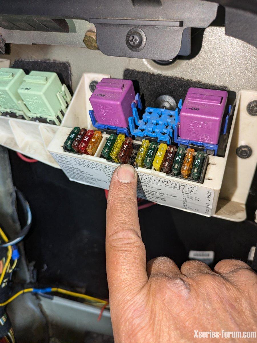

Finally the swithed live is already fused by fuse 80. Swap the 20A fuse for a 15A. The pic shows the location of fuse 80
It is better not to buy the extension kit as you only need the relay plus relay plug, 2m and 1m of 2.5mm sq cable (different colours) and some blue crimp connectors.
