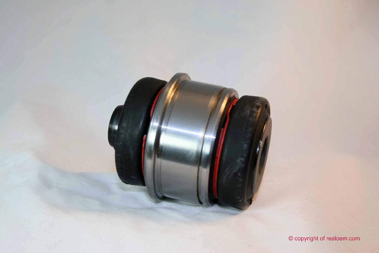

Lower hub carrier balljoint is the usual suspect for squeaking defo not a DIY job unless you have the correct tool to press the new balljoint in and out of the hub carrier, the only way to get a diagnosis of worn rear suspension parts is to release the air from the air bags otherwise the suspension is under load and wear cannot be located, thats why so many X5's with knackered rear suspension sail through MOT's.

Yeah it's sorted. Was rear ball joints as suspected. I also had the tell tale clunk when pulling away from a stand still.

Revisited this earlier this morning.
No play in the arms but the lower balljoint (the one between the hub carrier and the bottom wishbone) is hosed - how did I miss that :-[

Squeaking is usually the ball joint. Can be done yourself if you have the tool. I've replaced both mine. To look at they look fine until you get them out and they just fall apart. I have the tool if you do wish to hire it.
