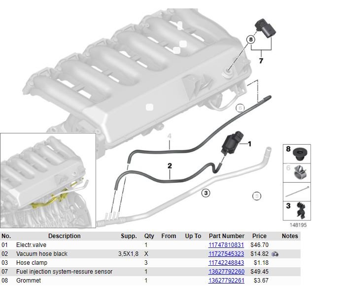

Re: X5 E70 EGR - Puzzled
I need help here.
Looking carefully at this diagram, my car only has part 01,02,03,07 & 08
Pipe 02 connects to the solenoid , part 01(solenoid), which connects to the diaphragm with a short pipe (not mentioned here) which moves the swirl flaps arm.
There is no 2nd (greyed out 4) pipe and the circled 6 is confusing me, as my car does not seem to have these/this parts.
Can anyone inform me of how my car should be connected up? Am I missing something, did my indi lose something when changing the glow plug controller
Think this could be the cause of my EGR issues, as it could be causing the vacuum to be incorrect in some way. My idle is also a little rough these days it seems, even though I put injector cleaner through recently.
Thanks
Thanks
