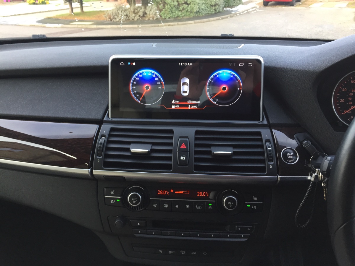

Finally updated screen
I’d be putting off updating the screen since purchase, though now completed I’m left thinking why I never done this sooner

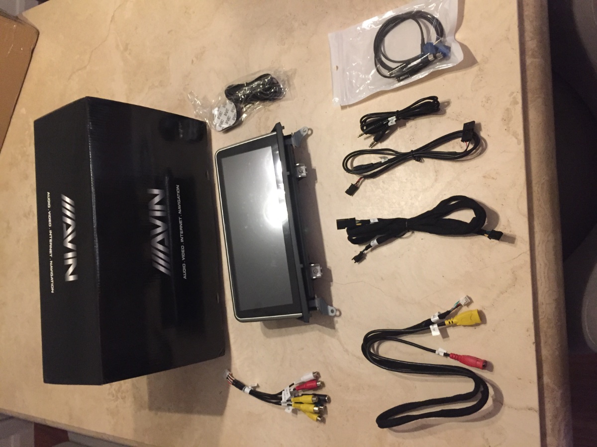

Avin 8.1 installed now on their 3rd incarnation, full touch screen Android system
Opening the box and install was, relatively easy though multiple unnecessary wires caused a lot of confusion
Whilst the screen is Android and car play compatible, there’s multiple horror stories of dismay in the Android offering poor sound quality as it’s feed through the Aux cable. A risk I didn’t want to explore as I can retain the OEM side and Bluetooth stream or use USB wire and play from phone through the Individual sound system for seemless Audio, as such I haven’t explored much of the Android side (yet)
The Avin screen does offer updated looks and really lifts the dash

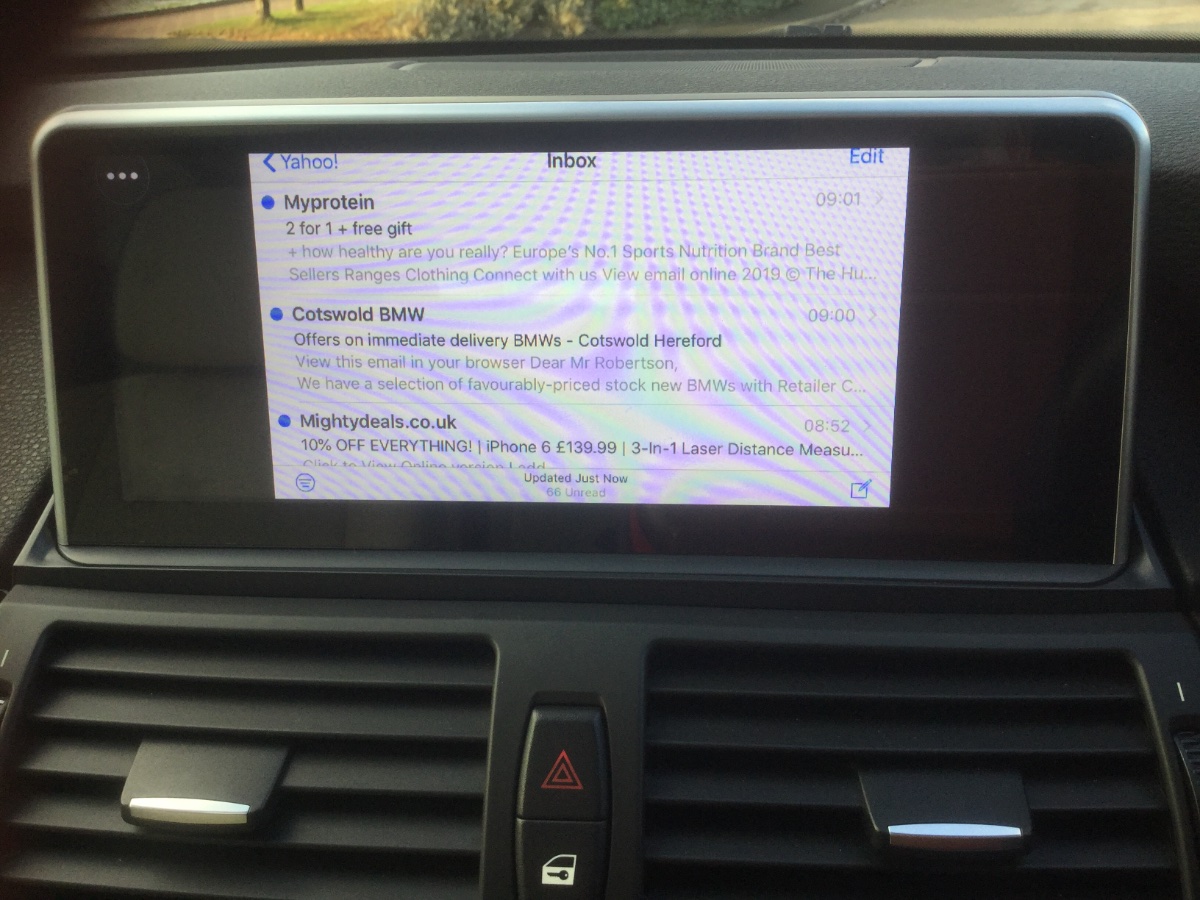

The screen also offers the benefit of mirror link, where you can personal hotspot your phone and display the phones screen, this gives the benefit to a wealth of free online navigation apps

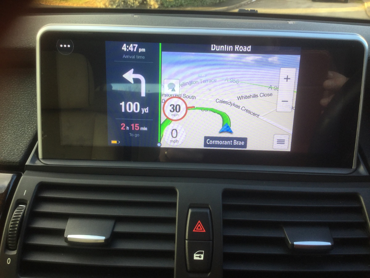

Whilst I purchased screen c/w Igo offline Europe maps & gps splitter at present I’m unable to get working, at present the Android side is not receiving GPS signal, whether it’s a box unticked or a damaged / incorrectly seated I’ve no idea, though something I’ll explore later, however I think I may have the wrong maps supplied....
I also purchased and never installed the GPS antenna, as it looks like it sits on the dash, which I don’t want..
I’ll most likely leave as is and utilise the mirror link and iPhone map apps
With the Personal hotspot, you can display and mirror so e mail access either online from screen or from online phone source, as the screen is touch sensitive it’s relatively easy to navigate
I’ve still got loads to explore on the Android side, my primary reason for purchase was to update & refresh the dash purely cosmetic as it still offers full OE functions, though with the added merits and it certainly delivered on my remit!
Longevity and reliability still to be tested so time shall tell on its true value!
Appreciate it’s not a new update, however very worthwhile in my opinion.

Currently I’m not receiving Android GPS, it’s too cold to muddle through..

're the GPS, did you order the GPS two way cable?
This splits the GPS input between the original head unit and the android unit and therefore no need for the supplied dash cable.
Also ref the igo Sat nav, go into file manager and delete it and then download and prioritize your preferred choice of Google maps or waze or whatever.

moggyboy wrote: Mon Jan 21, 2019 12:14 am 're the GPS, did you order the GPS two way cable?
I'm still finding new tricks but slow learning is me being a luddite.
I think, that’s where my problem “may” lie
I did use the Avin GPS splitter, connecting the single branch to the cars connector and the yee branch to MUlf and screen. I’m thinking I may have, allbeit unlikely, damaged the cable after multiple attempts to get the mulf unit back in.
I’m now weighted up the benefit of stripping down
The easy option would be to remove screen and plug in Avin antenna to check GPS connectivity
I can’t help think there is a box ticked/unticked to assign the OE antenna, so I’ll explore the setting screen first.
Good tip on IGo maps, though I guess I have to resolve the point above first

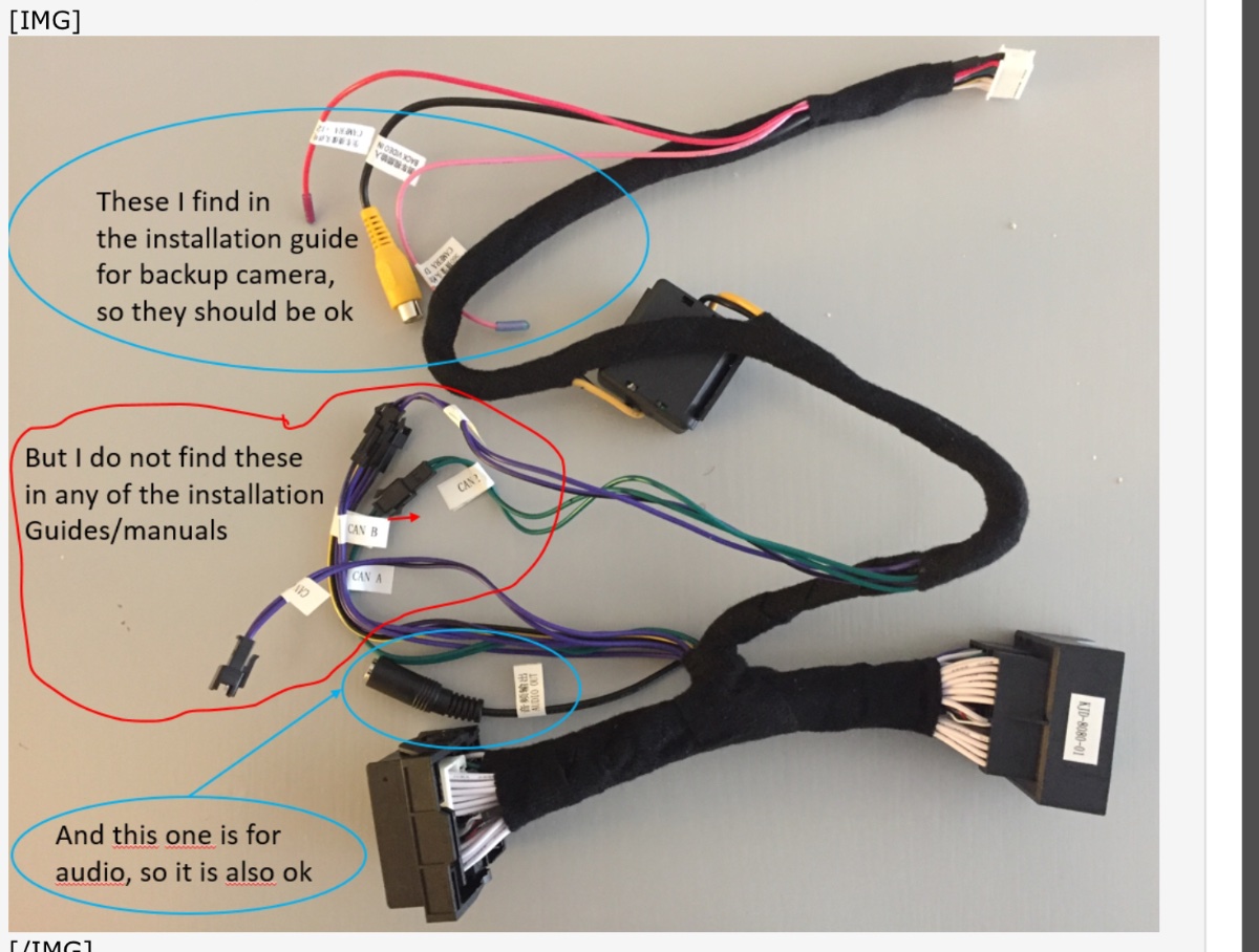

How odd!Rock007 wrote: Mon Jan 21, 2019 2:43 am Regarding ground wire.
On my one i can hear the alternator noise and doing a bit of research i came to the understanding that i need to have a good ground connection to get rid of the noise im getting through the speakers.
But my android screen did not come with any ground wire.
So im a bit confused with this screen.
Does your harness from MUlf to screen have the big black box? Perhaps that’s the suppressor
The picture below is similar to my harness, with the black box, however I had a separate loom from screen connector that allowed the box to be tucked behind the MUlf unit (it caused much frustration trying to run through dash..) I’m thinking, there’s no sound from the screen, it’s all processed in the MUlf unit and sent to amplifier in the back
As such I don think the screen would need an additional earth
The X5 is notorious for earth faults, both the chassis to engine block & battery lead is known issues...
The engine strap is braided wire, prone to corrosion
The battery lead has the intelligent Battery sensor
As a quick means of checking, I’d get a battery jump lead, connect one side to the negative pole on the strut tower and the other on the engine block, see if the noise disappears. Then work back to the battery, connecting from battery negative to engine block
