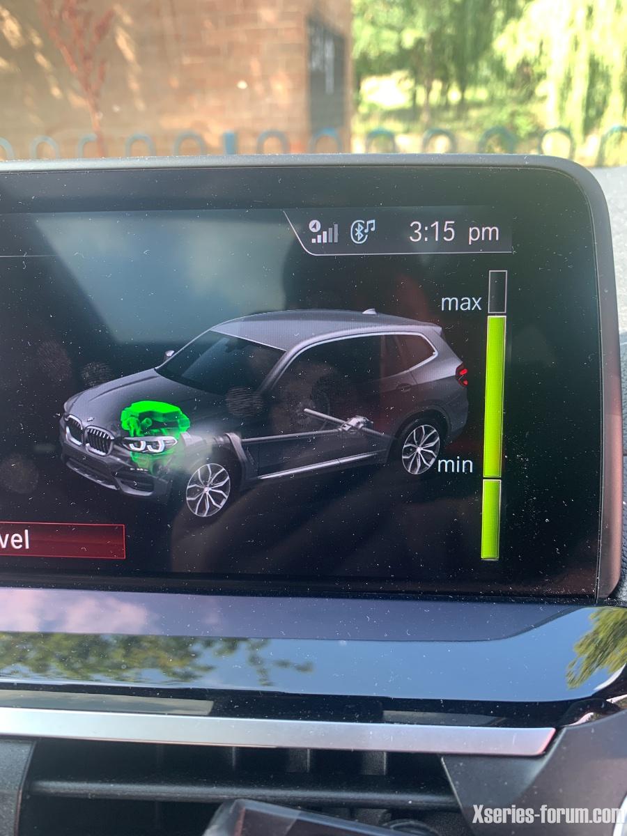

Hi I’ve just Donne a oil level check on the car and it looks ok but I’m uncertain if it should be right at the top of the scale or at the top of the next section down
Hopefully this is explained better in the picture added
Cheers col

On my F25 if the level goes above where yours is the top bar is red. I assume that means over-full.
IMHO yours is spot-on.

Looks spot on to me too. On my X6, the dipstick says low, but the iDive looks like yours.

Thanks for the responses I tend to think that the extra block is to say it’s overfilled

StuBeeDoo wrote: Sun Aug 22, 2021 5:08 pmOn my F25 if the level goes above where yours is the top bar is red. I assume that means over-full.
I should have added "if I recall correctly". I only ever saw it the first time I did an oil change and went by the dipstick, and that was 3 years ago. Every change I've done since I've put 7ltrs in and kept adding 250ml at a time until I got to the top of the central bar on the display.

On mine, when it pings up with check oil level, I add 1 bottle (1 litre???) and that takes it to the full mark as shown on the picture.

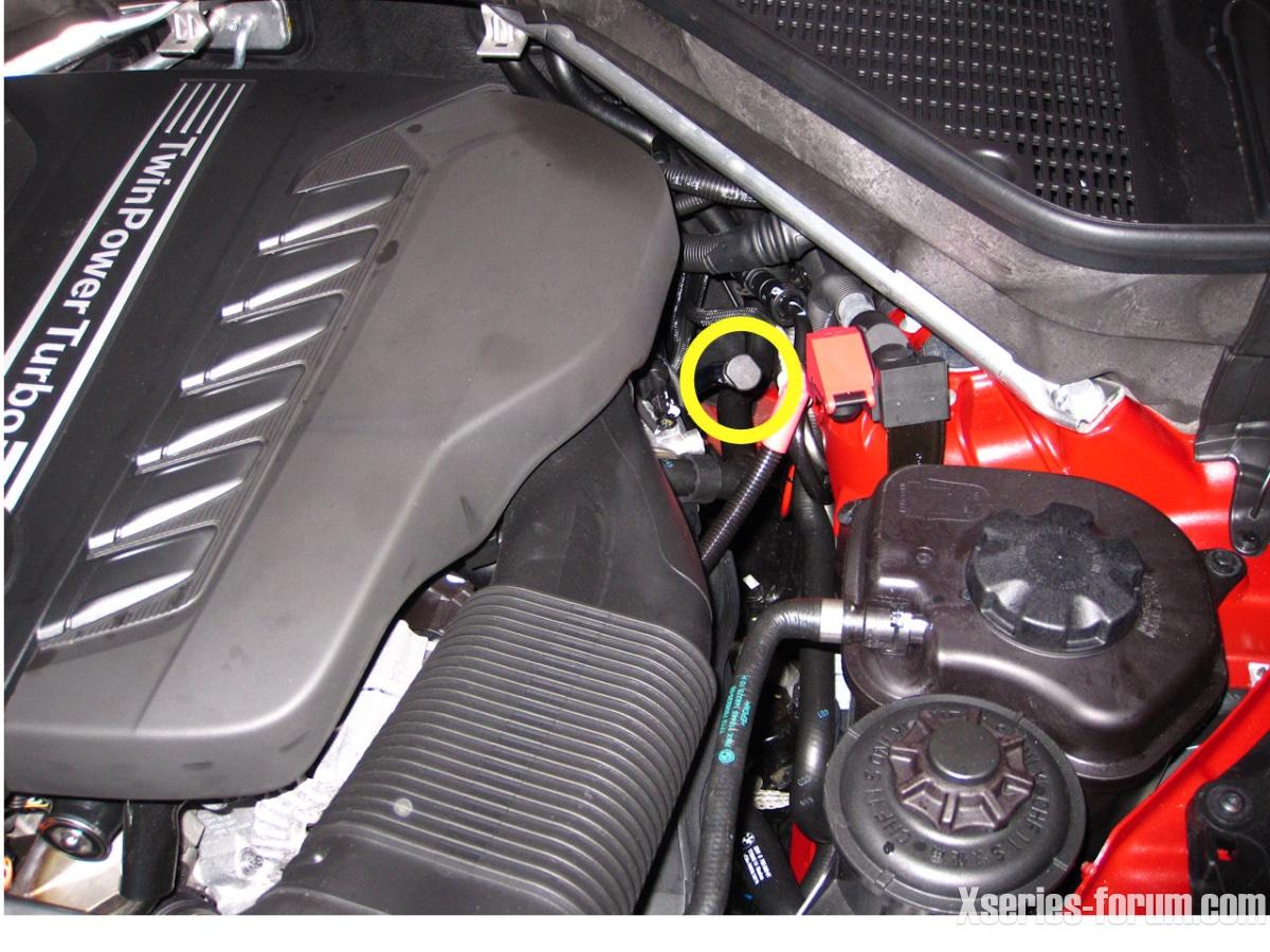

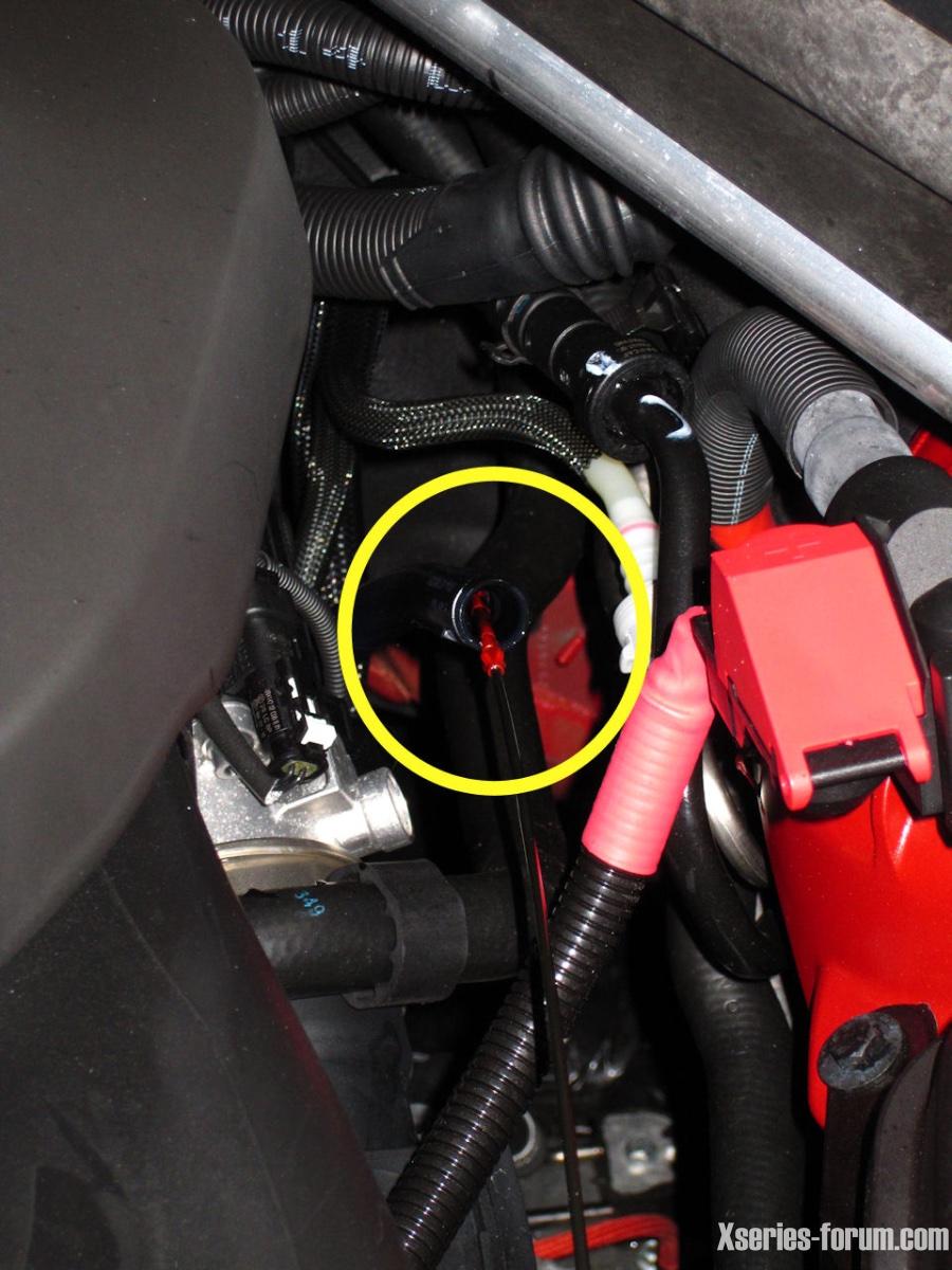

Post by X5Sport » Wed Aug 25, 2021 8:35 am
You mean this one: Right side of engine towards the back. I know mine is the N57 engine but I thought that they all had one, even if BMW didn’t make it obvious or mention it anywhere.
RealOEM says there should be one on the E70 & E71 from start of production, and for all engines - but there have been persistent rumours that certain models didn’t have one!
