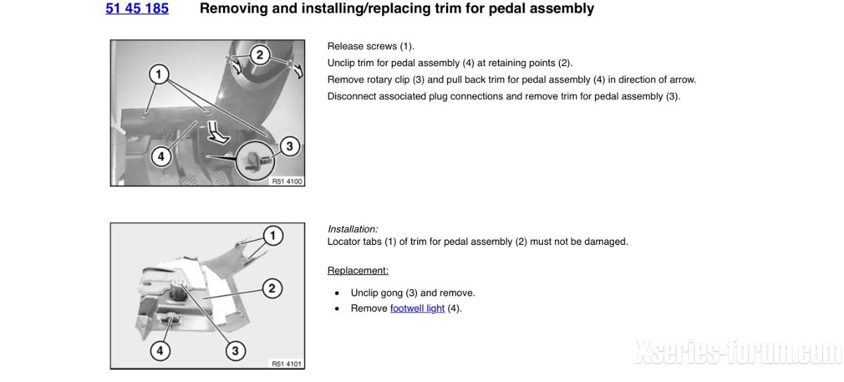

If you have a look at RealOEM (copy of the BMW Parts database on line) and use the last 7 of your VIN in the ‘Serial Number’ box it will bring up your specific model. The sub-section is ‘Pedals’ and should bring back this diagram: https://www.realoem.com/bmw/enUS/showpa ... Id=35_0258
You want item 7. Part number is on that line.
