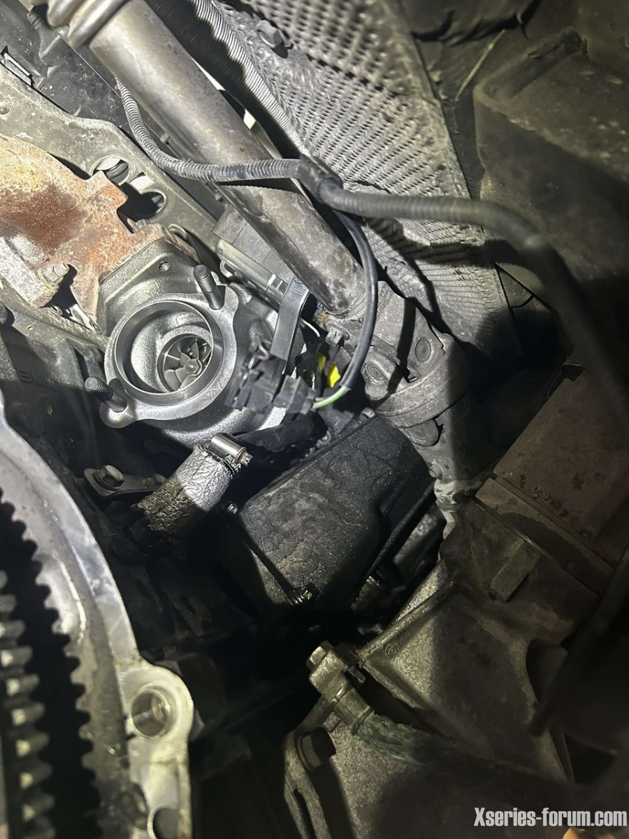

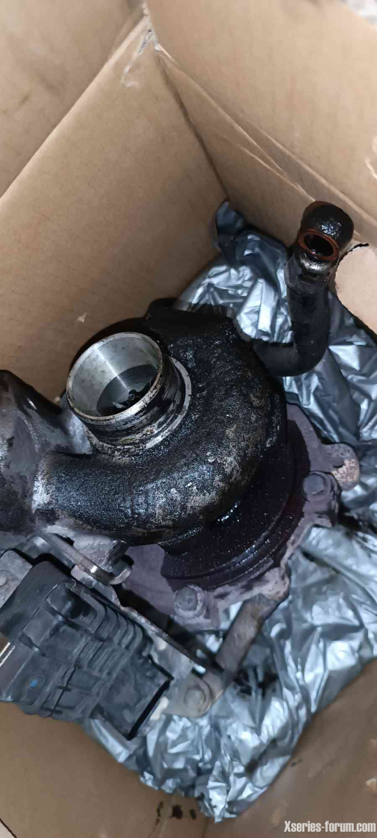

Post by napz00r » Wed Sep 04, 2024 8:28 pm
old vs new. fitted perfectly.

Post by Leslie » Wed Sep 04, 2024 9:04 pm
Good job and welcome :thumbsup:
