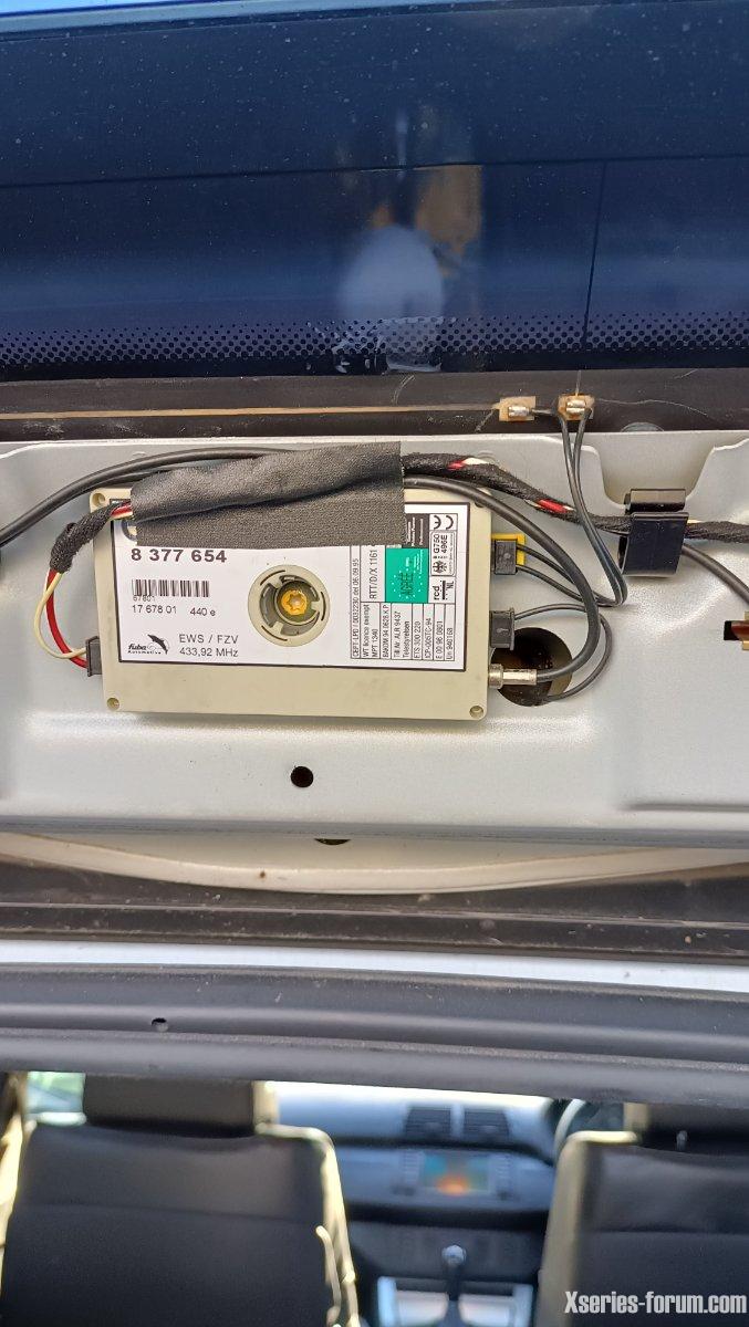

I removed the tailgate trim at the top and this is what I found.

There is an antenna connection that was taped to the frame - it looked like factory fabric tape so maybe it’s been there forever..

The unit is the aerial amplifier module. 433.92MHz is also for the central locking. E53s were made with a single loom (unlike all later models) so maybe the ‘spare’ was for one of the cellular options. Possibly for the US satellite based radio Sirius(?).
Did plugging the errant cable back in fix the issue though?

I didn’t plug the errant cable into anything. It didn’t fit anywhere.
I did unplug the antenna cable from the box and back in again- and further along there is a connection that I did the same. I haven’t tried it yet.
