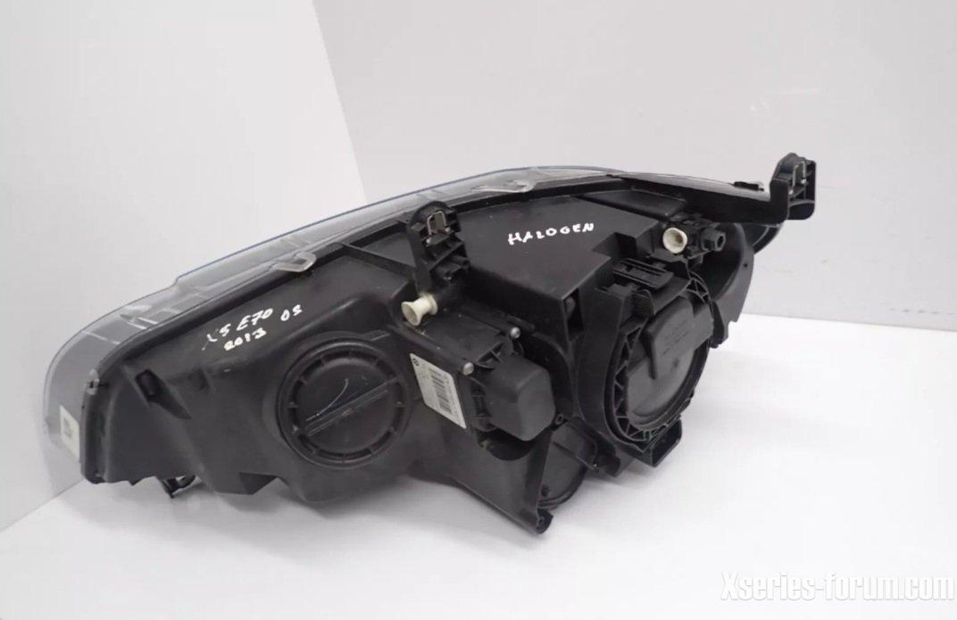

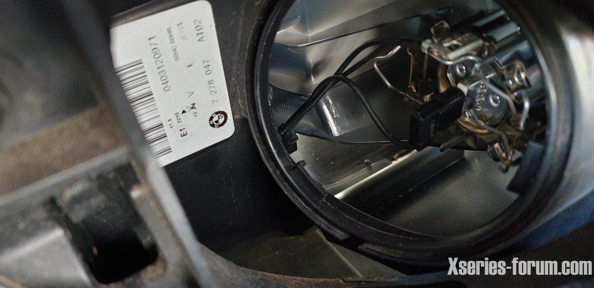

Headlights for sale show two ports which mine has, .but when i open the smaller on my car, all i see is the back of what i assume is an H7? Where is the H8 located?

My understanfding has always been when your sat behind the wheel Right hand side (Drivers side UK) and Left hand side (Passenger side)
The picture you posted showing the Bulb is the passenger side (left) headlamp and that is the H1 lamp, the other cover will have an H7 lamp behind it. The picture of the back of a headlamp unit you can see an oblong cover held in place by 3 screws between the two round covers behind that is the Parking/Halo lamp.
That is just about impossible to get at with the Headlamp unit in place (or I found it so) My local Dealer quoted £87 + VAT for just the parking/Halo lamp
