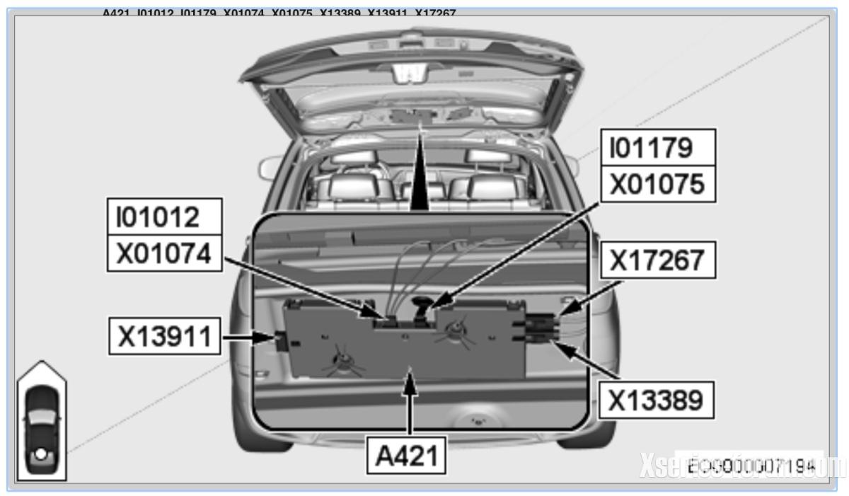

The central locking is controlled by the Junction Box Electronics module (basically the rear fusebox) actioning instructions from the Car Access System that in turn is getting instructions from the Remote Control Receiver. The receiver is part of the antenna diversity unit and mounted at the top of the upper tailgate.
You’ll need to get the inner trims off to get to it. It could well just be a broken wire meaning the car isn’t receiving the key signal. You could try holding the key very close to the upper rear window area to see what happens.
What is the condition of the rear window heating and aerial elements on the glass? They need to be intact.

The central locking antennas are in the aerial diversity unit as above. Module A421. It is static sensitive, but a battery change should not have caused any issues. If the radio is working then that tends to show at least part of the module is fine.
The module receives the signals from the keys and if valid passes the ‘OK’ to the CAS. That then in turn sends a signal to the JBE and that triggers the locks. The keys use a rolling code security key. Something pretty odd must have happened to mess up the CAS. When a new battery is installed it has to be coded to the car (you can’t just swap them) and that coding change is stored in the CAS - the same module for the keys. So if the CAS was messed up, did anything else across the systems get affected - like the diversity unit.
If the CAS has the keys programmed in then this points at the diversity module or any of the antennas mounted in the rear spoiler. But if the radio works AM/FM that suggests the module itself. Used ones are about £100, new three times that much.
